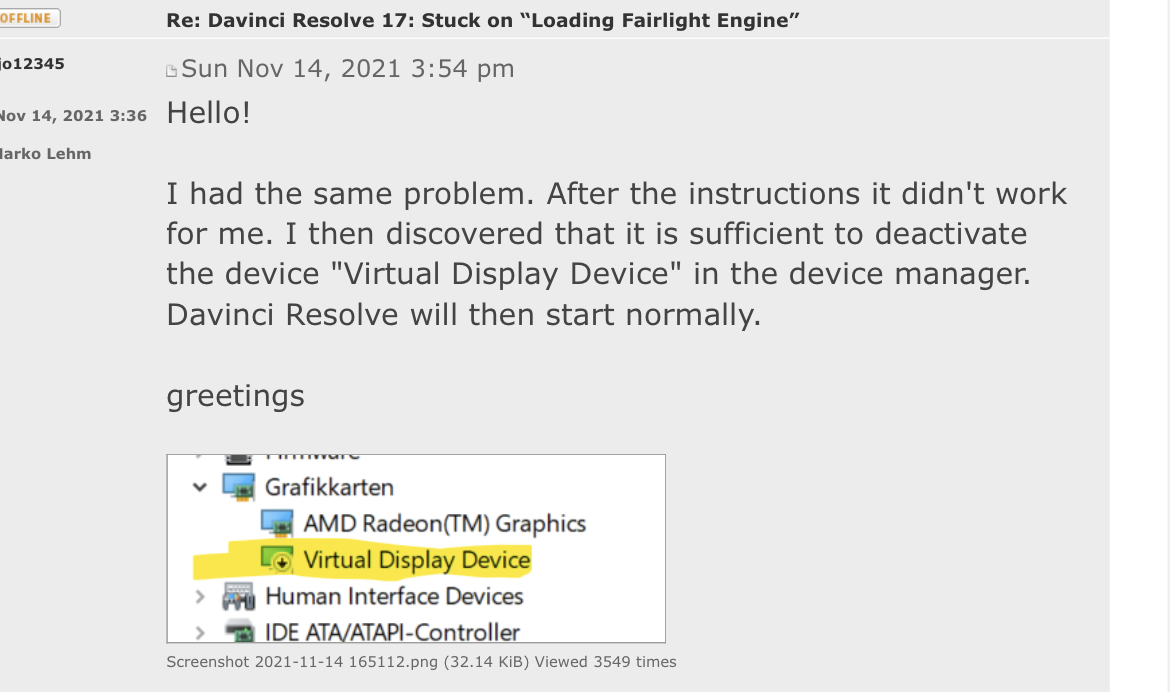

Many people also report solving similar issue by disabling additional graphics devices in Device Manager, have your tried that yet?

So, this is what I got (and thank you for the better explanation then I could find on the forums.
Will try and check out the Virtual Display Device when i'm back.
